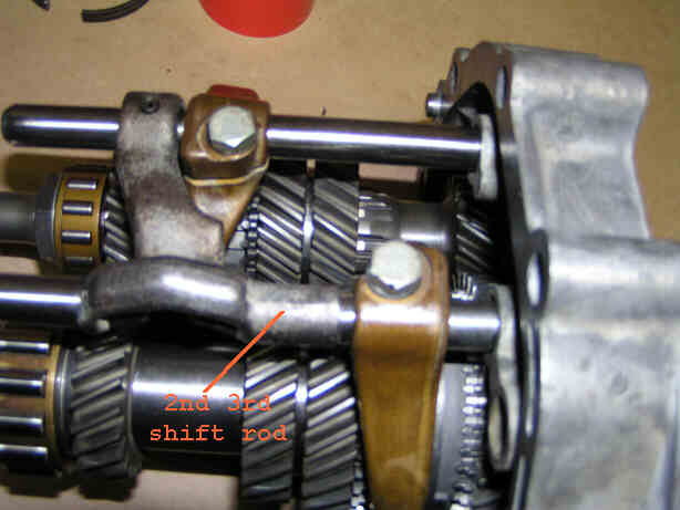

DNHunt   Next I put the 2nd, 3rd shift fork on its' sli...   Nov 6 2005, 12:50 PM
DNHunt   Next, 2nd, 3rd shift rod! These bolts are only...   Nov 6 2005, 12:52 PM
