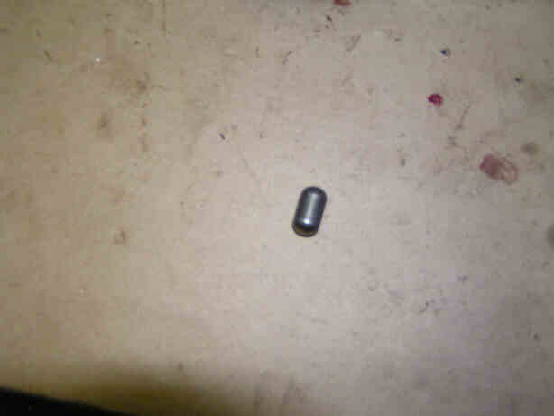

Next is the little peanut thing in the tube in the intermediate plate.

DNHunt   Next is the little peanut thing in the tube in the...   Nov 6 2005, 12:53 PM
DNHunt   After you shove it in you should be able to just b...   Nov 6 2005, 12:56 PM
