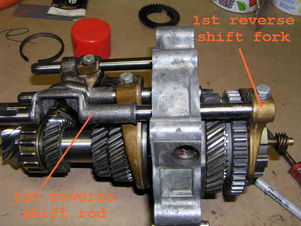

Next the 1st, reverse shift rod and shift fork go on with the bolt finger tight.

DNHunt   Next the 1st, reverse shift rod and shift fork go ...   Nov 6 2005, 01:00 PM
