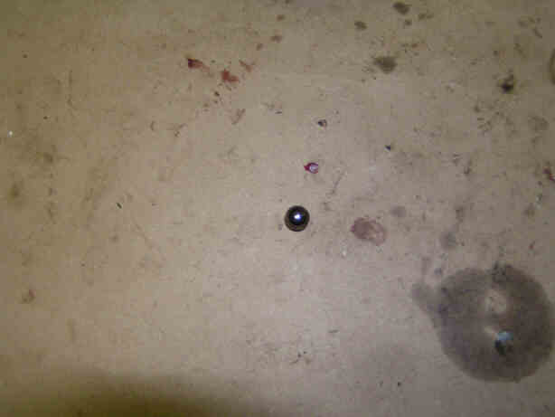

The 3rd and final ball goes in the tube

DNHunt   The 3rd and final ball goes in the tube   Nov 6 2005, 01:01 PM
