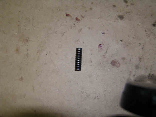

DNHunt   Then the stiffer of the 2 springs   Nov 6 2005, 01:02 PM
DNHunt   You can see the last spring in the hole   Nov 6 2005, 01:03 PM
