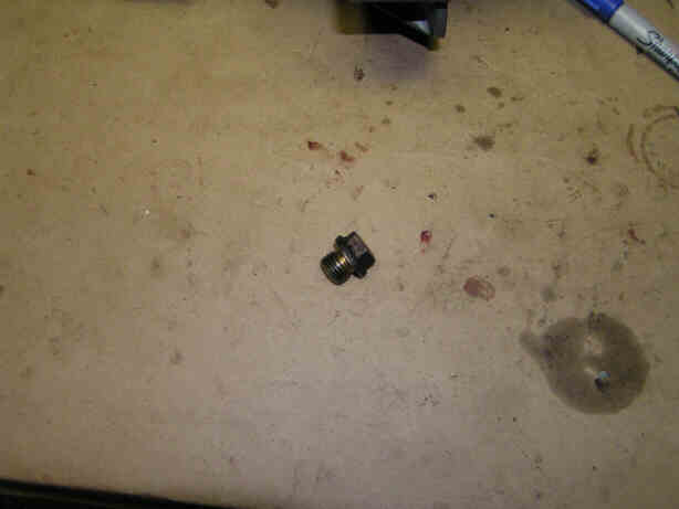

The plug finishes it up

DNHunt   The plug finishes it up   Nov 6 2005, 01:04 PM
DNHunt   Done with that   Nov 6 2005, 01:04 PM
