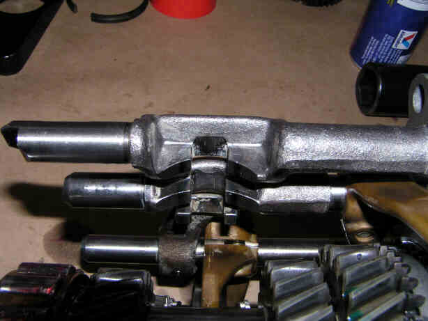

This is a side shifter!!!
Adjusting the shift forks for 2nd, 3rd and 4th, 5th can be done now. The balls and springs will hold the shift rods in neutral and the alignment jig supports the free ends of the rods. You should be able to see all of the notches in the shift rods lined up. Like this

DNHunt   This is a side shifter!!! Adjusting t...   Nov 6 2005, 01:18 PM
DNHunt   The jig holds everything nice and steady   Nov 6 2005, 01:19 PM
DNHunt   Tighten the bolts when the sliders for 2nd, 3rd an...   Nov 6 2005, 01:23 PM
