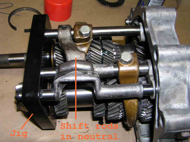

DNHunt   This is a side shifter!!! Adjusting t...   Nov 6 2005, 01:18 PM
DNHunt   The jig holds everything nice and steady   Nov 6 2005, 01:19 PM
DNHunt   Tighten the bolts when the sliders for 2nd, 3rd an...   Nov 6 2005, 01:23 PM
DNHunt   Haynes manual calls for 1mm clearance between the ...   Nov 6 2005, 02:30 PM
