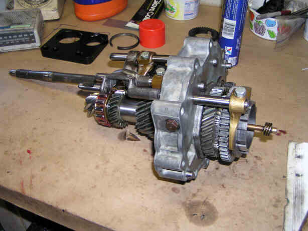

DNHunt   Shift forks, shafts and detents. I really like thi...   Nov 6 2005, 12:33 PM
DNHunt   Start with the 4th, 5th shift fork on it's sli...   Nov 6 2005, 12:35 PM
DNHunt   Next I inserted it's shift rod.   Nov 6 2005, 12:37 PM
DNHunt   Then I added the ball that is part of the detent i...   Nov 6 2005, 12:39 PM
DNHunt   All these balls, springs, and rods go in this hole...   Nov 6 2005, 12:43 PM
DNHunt   Next comes a spring with the little rod inside it....   Nov 6 2005, 12:44 PM
Aaron Cox   as joe sharp said yesterday - the ball and stick g...   Nov 6 2005, 12:46 PM
DNHunt   Then comes the second ball. You shoud be able to s...   Nov 6 2005, 12:48 PM
DNHunt   Next I put the 2nd, 3rd shift fork on its' sli...   Nov 6 2005, 12:50 PM
DNHunt   Next, 2nd, 3rd shift rod! These bolts are only...   Nov 6 2005, 12:52 PM
DNHunt   Next is the little peanut thing in the tube in the...   Nov 6 2005, 12:53 PM
DNHunt   After you shove it in you should be able to just b...   Nov 6 2005, 12:56 PM
DNHunt   Next the 1st, reverse shift rod and shift fork go ...   Nov 6 2005, 01:00 PM
DNHunt   The 3rd and final ball goes in the tube   Nov 6 2005, 01:01 PM
DNHunt   Then the stiffer of the 2 springs   Nov 6 2005, 01:02 PM
DNHunt   You can see the last spring in the hole   Nov 6 2005, 01:03 PM
DNHunt   The plug finishes it up   Nov 6 2005, 01:04 PM
DNHunt   Done with that   Nov 6 2005, 01:04 PM
qa1142   Very cool stuff   Nov 6 2005, 01:09 PM
DNHunt   This is a side shifter!!! Adjusting t...   Nov 6 2005, 01:18 PM
DNHunt   The jig holds everything nice and steady   Nov 6 2005, 01:19 PM
DNHunt   Tighten the bolts when the sliders for 2nd, 3rd an...   Nov 6 2005, 01:23 PM
DNHunt   Haynes manual calls for 1mm clearance between the ...   Nov 6 2005, 02:30 PM
DNHunt   The gear stack is now ready except for torquing th...   Nov 6 2005, 02:32 PM
DNHunt   The paper shims for the intermediate plate were no...   Nov 6 2005, 02:34 PM
DNHunt   One old shim measured .009"   Nov 6 2005, 02:36 PM
DNHunt   The other old one was .006   Nov 6 2005, 02:37 PM
DNHunt   It just so happens that there was an .009" in the ...   Nov 6 2005, 02:38 PM
DNHunt   And lucky me an .006. I guess I'm good to go.   Nov 6 2005, 02:38 PM
