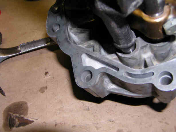

The paper shims for the intermediate plate were not colored and the replacements in the gasket kit are not either so I had to measure them. I chose a none compressed area in each. There are passages or something where the castings are not solid and the sealing surfaces do not compress the shims. The old ones added up to .015".

DNHunt   The paper shims for the intermediate plate were no...   Nov 6 2005, 02:34 PM
DNHunt   One old shim measured .009"   Nov 6 2005, 02:36 PM
DNHunt   The other old one was .006   Nov 6 2005, 02:37 PM
DNHunt   It just so happens that there was an .009" in the ...   Nov 6 2005, 02:38 PM
DNHunt   And lucky me an .006. I guess I'm good to go.   Nov 6 2005, 02:38 PM
