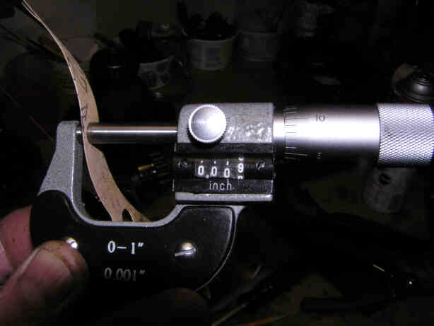

DNHunt   Haynes manual calls for 1mm clearance between the ...   Nov 6 2005, 02:30 PM
DNHunt   The gear stack is now ready except for torquing th...   Nov 6 2005, 02:32 PM
DNHunt   The paper shims for the intermediate plate were no...   Nov 6 2005, 02:34 PM
DNHunt   One old shim measured .009"   Nov 6 2005, 02:36 PM
DNHunt   The other old one was .006   Nov 6 2005, 02:37 PM
DNHunt   It just so happens that there was an .009" in the ...   Nov 6 2005, 02:38 PM
DNHunt   And lucky me an .006. I guess I'm good to go.   Nov 6 2005, 02:38 PM
