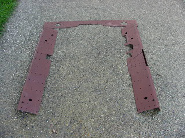

the kit..

bender   the chassis stiffening kit   Nov 5 2005, 04:17 PM
McMark   You have a significant job in front of you. If ca...   Nov 5 2005, 04:17 PM

McMark   The chassis stiff kit get attached farther back th...   Nov 5 2005, 04:19 PM

Bleyseng   I hope you got that car for free as its gone IMHO ...   Nov 7 2005, 05:30 PM
Verruckt   I agree with Bleyseng. Unless you are super good w...   Nov 7 2005, 05:41 PM
