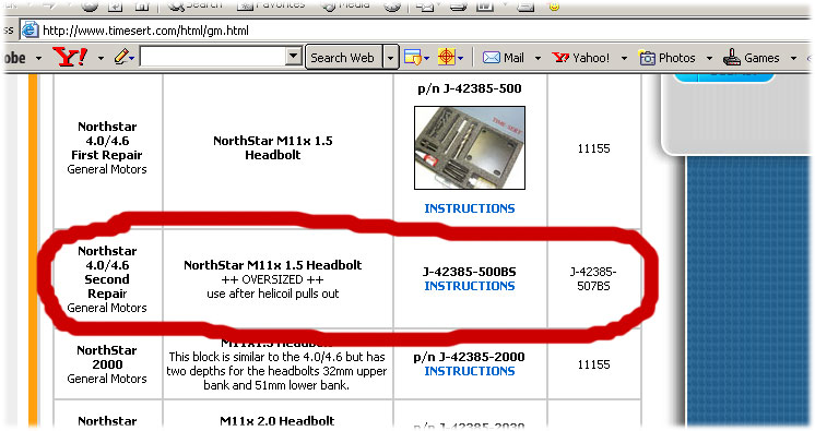

I guess you didn't see the 2nd kit TimeCert sells (IMG:http://www.914world.com/bbs2/html/emoticons/smile.gif)
It's made "just" for HeliCoils (IMG:http://www.914world.com/bbs2/html/emoticons/biggrin.gif) (IMG:http://www.914world.com/bbs2/html/emoticons/laugh.gif)
