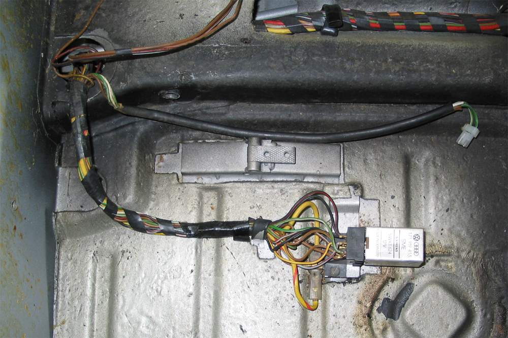

ok....we are in the assembly mode on my sons restoration.
Does anyone have a pic of the wiring under the passenger seat...
Specifically I am looking for how it is mounted to the floor and the correct position.
the system is already jumpered, but I would like to mount it the way it is supposed to be, that way it wont rattle loose or get caught in something else.
Rich

Just happen to have my '76 project car right here in the garage.
One of the few parts not yet removed.
It's very original, only about 32,000 miles.
Looks like they just connected the big yellow wire to bypass the buzzer.

dsmeyer   A little more detail...   Nov 9 2005, 05:02 PM
Aaron Cox   wierd. i have a FAT relay under there.. like 2 or ...   Nov 9 2005, 05:21 PM
dsmeyer   ...   Nov 9 2005, 05:35 PM
2-OH!   Yep, the fat relay lookin' do-dad is the seat ...   Nov 9 2005, 05:36 PM
lagunero   where all models fit with a relay that size? The P...   Nov 9 2005, 06:13 PM
jim_hoyland   Nice picture; maybe we can get a good pic of the 2...   Nov 9 2005, 09:33 PM
double-a   here's how the relay/wires look in my '75....   Nov 10 2005, 12:06 AM
double-a   here's another look, a bit closer. ~a   Nov 10 2005, 12:08 AM
jim_hoyland   Nice pic of the '75; I'm going to check mi...   Nov 10 2005, 09:26 AM
