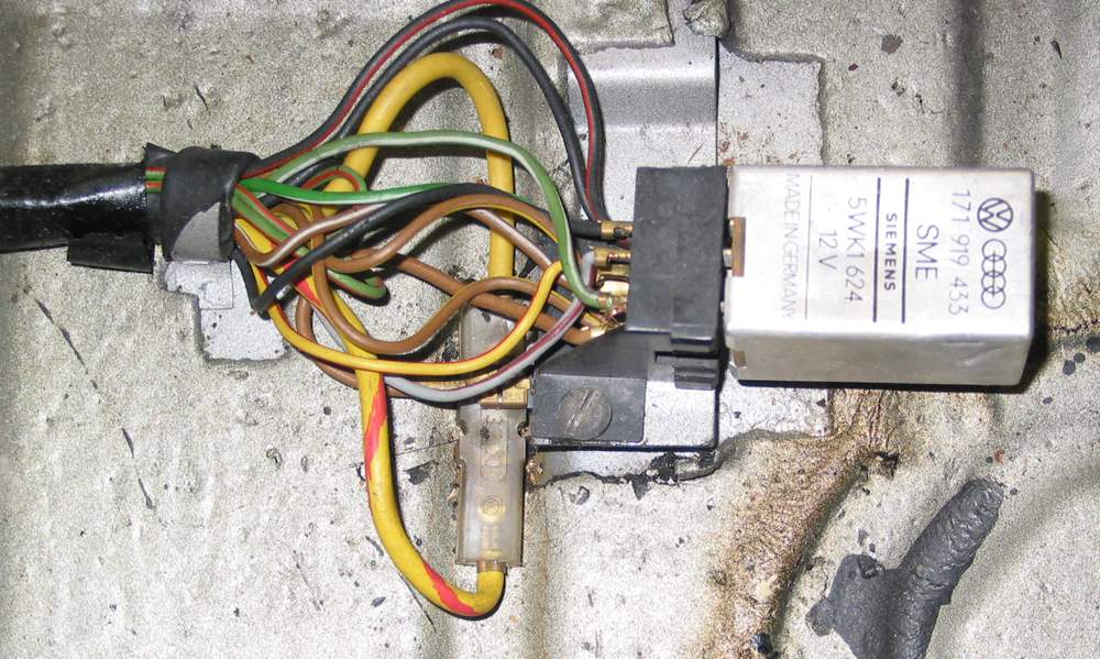

ok....we are in the assembly mode on my sons restoration.
Does anyone have a pic of the wiring under the passenger seat...
Specifically I am looking for how it is mounted to the floor and the correct position.
the system is already jumpered, but I would like to mount it the way it is supposed to be, that way it wont rattle loose or get caught in something else.
Rich

A little more detail...

dsmeyer   Just happen to have my '76 project car right h...   Nov 9 2005, 05:01 PM
dsmeyer   A little more detail...   Nov 9 2005, 05:02 PM
Aaron Cox   wierd. i have a FAT relay under there.. like 2 or ...   Nov 9 2005, 05:21 PM
dsmeyer   ...   Nov 9 2005, 05:35 PM
2-OH!   Yep, the fat relay lookin' do-dad is the seat ...   Nov 9 2005, 05:36 PM
lagunero   where all models fit with a relay that size? The P...   Nov 9 2005, 06:13 PM
jim_hoyland   Nice picture; maybe we can get a good pic of the 2...   Nov 9 2005, 09:33 PM
double-a   here's how the relay/wires look in my '75....   Nov 10 2005, 12:06 AM
double-a   here's another look, a bit closer. ~a   Nov 10 2005, 12:08 AM
jim_hoyland   Nice pic of the '75; I'm going to check mi...   Nov 10 2005, 09:26 AM

jim_hoyland   Mine was worse than I thought. First, the dash sea...   Nov 10 2005, 09:22 PM
Jeff Bowlsby   Here you go guys, I hope this helps. This wiring d...   Nov 10 2005, 09:42 PM
Dave_Darling   ...   Nov 10 2005, 09:49 PM
double-a   ok, i'll just leave it as-is, since the two wi...   Nov 10 2005, 10:05 PM
jim_hoyland   Dave, Your point is well taken; you are right abou...   Nov 10 2005, 10:51 PM
