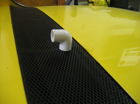

A 1½" ABS plumbing 90° zip tied to the front suspension and aimed at the brakes.
I'll try it this weekend on the track.
It won't hurt, remember that.

trekkor   clamps, clamps... the lower rod of the a-arm is a...   Nov 9 2005, 10:20 PM
brant   Ok... thanks for the pictures. I see. hmmm. brant   Nov 9 2005, 10:24 PM
trekkor   this is how I had it mounted until the manufacture...   Nov 9 2005, 10:31 PM

trekkor   So, if I run the duct work from the the air dam to...   Nov 9 2005, 11:33 PM
Aaron Cox   go through the fenderwells, ala PMS setup. they v...   Nov 9 2005, 11:50 PM
Aaron Cox   also - you ever think of vented rotors? might ...   Nov 9 2005, 11:50 PM
trekkor   two dollar budget- remember?   Nov 9 2005, 11:57 PM

trekkor   Just got back from my track day. Didn't knock ...   Nov 13 2005, 08:09 PM
