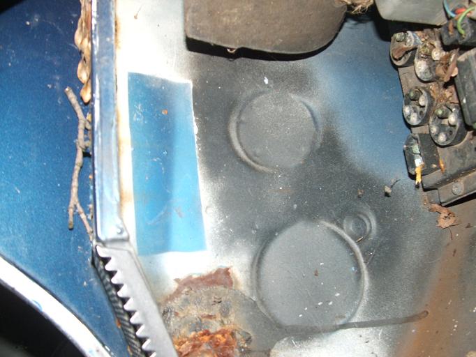

> rust in the rocket panel area, any ideas how to handle this rust?

guys do you think its a serious rust??
and i know i need to buy the rocket panel , do i need more parts for it?

BMartin914   That IS serious rust. That is your longitudinal - ...   Nov 4 2005, 03:15 PM
Rand   The passenger side is usually worse, so be sure to...   Nov 4 2005, 05:08 PM
Verruckt   I think i see about an 1/8" of bondo in that third...   Nov 4 2005, 05:13 PM
boboli914@att.net   Yes it is serious. If you can weld and read it can...   Nov 4 2005, 05:30 PM

McMark   You have a significant job in front of you. If ca...   Nov 5 2005, 04:17 PM

McMark   The chassis stiff kit get attached farther back th...   Nov 5 2005, 04:19 PM

Bleyseng   I hope you got that car for free as its gone IMHO ...   Nov 7 2005, 05:30 PM
Verruckt   I agree with Bleyseng. Unless you are super good w...   Nov 7 2005, 05:41 PM

r_towle   2 clamshell kits both halves of the floor boards r...   Nov 7 2005, 11:48 PM
9146986   I'd say it would cost around $4500 to fix...   Nov 8 2005, 08:04 AM

Bleyseng   Its your time and money.....do what you want. The ...   Nov 8 2005, 09:56 AM

r_towle   guys, there is no such thing as a rust free chassi...   Nov 8 2005, 11:34 AM
Bleyseng   Locally, we have cars come up in the 1500-3000 ran...   Nov 8 2005, 03:16 PM

Bleyseng   Once the chassis starts to rust that bad its rusti...   Nov 8 2005, 04:45 PM

McMark   It's definitely fixable from a technical point...   Nov 9 2005, 10:16 PM
brant   bender, its not that its impossible... but I ver...   Nov 9 2005, 10:55 PM

sgomes   I'll add one note of caution. That car is so ...   Nov 10 2005, 08:15 AM

McMark   No the clamshell is only about %65 of the issue. ...   Nov 10 2005, 03:34 PM
Bleyseng   You still have to fix the rest of the rust in the ...   Nov 10 2005, 03:39 PM
