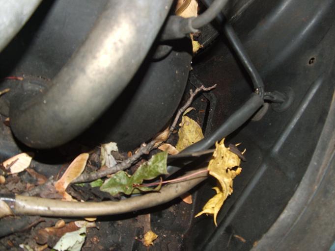

bender   guys i got pictures from the engine area, what do ...   Nov 9 2005, 10:02 PM
bender   more....   Nov 9 2005, 10:03 PM
bender   more..   Nov 9 2005, 10:04 PM
bender   and more..   Nov 9 2005, 10:04 PM
bender   the passenger side   Nov 9 2005, 10:06 PM
bender   more pass side   Nov 9 2005, 10:07 PM
bender   last one what do u think guys? i saw that in the f...   Nov 9 2005, 10:08 PM
McMark   It's definitely fixable from a technical point...   Nov 9 2005, 10:16 PM
brant   bender, its not that its impossible... but I ver...   Nov 9 2005, 10:55 PM
