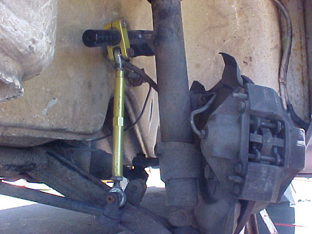

I, however, would be more concerned with the sway bar mount.
What the heck is the sway bar drop link attached to? It's not the mount ears on the a-arm. What is that thing at the lower end of the drop link.
The lower mount is provided by Smart Racing Products.
Absolutely bullet proof.
A couple of weeks ago a 914 racer crashed at 100 mph (IMG:http://www.914world.com/bbs2/html/emoticons/ohmy.gif)
The tie rod sheared off and the front suspension got all bent up. The SRP bar drop link did not even get bent or lose it's setting...true story. I saw it.
Here's a better pic of the mount.
KT

  Nov 9 2005, 10:11 PM Brando   http://www.914world.com/bb...   Nov 9 2005, 10:12 PM
brant     Nov 9 2005, 10:13 PM
SLITS   Appears to clamp to the transverse? rod.   Nov 9 2005, 10:15 PM
brant   I'm still confused... not enough beer tonight....   Nov 9 2005, 10:19 PM
trekkor   clamps, clamps... the lower rod of the a-arm is a...   Nov 9 2005, 10:20 PM
brant   Ok... thanks for the pictures. I see. hmmm. brant   Nov 9 2005, 10:24 PM
trekkor   this is how I had it mounted until the manufacture...   Nov 9 2005, 10:31 PM
Britain Smith   The SmartRacing set-up actually places the drop-li...   Nov 9 2005, 10:40 PM
JOHNMAN   Ok, I see the mount now. I hadn't seen those ...   Nov 9 2005, 11:13 PM
