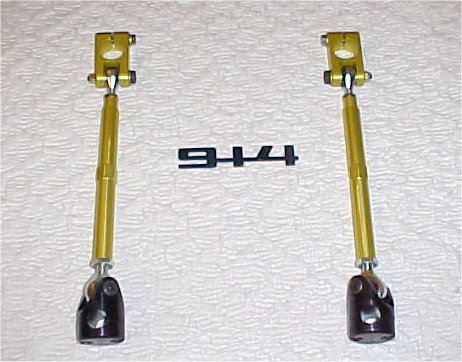

clamps, clamps...
the lower rod of the a-arm is a better location as the mount can pivot and give even more adjustability.
It won't fail, that's for sure.
