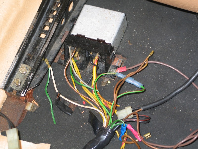

ok....we are in the assembly mode on my sons restoration.
Does anyone have a pic of the wiring under the passenger seat...
Specifically I am looking for how it is mounted to the floor and the correct position.
the system is already jumpered, but I would like to mount it the way it is supposed to be, that way it wont rattle loose or get caught in something else.
Rich

This may be a dumb question, but I really don't know: Where do the yellow wire go to. They are huge, I assume they are related to the start function. I don't recall seeing a yellow wire at the starter or solonoid. The pictures are great, hope to clean this mess up.

double-a   i could get a clue on this as well. i have two set...   Nov 8 2005, 11:52 PM
mercdev   I'm not 100% sure since my car has had other P...   Nov 9 2005, 12:07 AM
jim_hoyland   Ditto: I'm also looking to restore the origina...   Nov 9 2005, 08:24 AM
2-OH!   Sorry guys, all 3 of my previous restorations, I d...   Nov 9 2005, 02:23 PM
dsmeyer   Just happen to have my '76 project car right h...   Nov 9 2005, 05:01 PM
dsmeyer   A little more detail...   Nov 9 2005, 05:02 PM
Aaron Cox   wierd. i have a FAT relay under there.. like 2 or ...   Nov 9 2005, 05:21 PM
dsmeyer   ...   Nov 9 2005, 05:35 PM
2-OH!   Yep, the fat relay lookin' do-dad is the seat ...   Nov 9 2005, 05:36 PM
lagunero   where all models fit with a relay that size? The P...   Nov 9 2005, 06:13 PM
jim_hoyland   Nice picture; maybe we can get a good pic of the 2...   Nov 9 2005, 09:33 PM
double-a   here's how the relay/wires look in my '75....   Nov 10 2005, 12:06 AM
double-a   here's another look, a bit closer. ~a   Nov 10 2005, 12:08 AM
jim_hoyland   Nice pic of the '75; I'm going to check mi...   Nov 10 2005, 09:26 AM

jim_hoyland   Mine was worse than I thought. First, the dash sea...   Nov 10 2005, 09:22 PM
Jeff Bowlsby   Here you go guys, I hope this helps. This wiring d...   Nov 10 2005, 09:42 PM
Dave_Darling   ...   Nov 10 2005, 09:49 PM
double-a   ok, i'll just leave it as-is, since the two wi...   Nov 10 2005, 10:05 PM
jim_hoyland   Dave, Your point is well taken; you are right abou...   Nov 10 2005, 10:51 PM
ejm   Scotch locks suck as a reliable way to make a conn...   Nov 11 2005, 01:18 AM

r_towle   this diagram from Bowlsby should be in the classic...   Nov 23 2005, 08:29 PM
double-a     Nov 23 2005, 08:43 PM
jim_hoyland   I've been wondering how the relay worked. My o...   Nov 23 2005, 10:02 PM
r_towle   I was just informed that it may be that these have...   Nov 23 2005, 10:38 PM
jim_hoyland   Now we're getting somewhere ! Really looki...   Nov 23 2005, 11:06 PM
MecGen   You Guys http://www.914w...   Nov 24 2005, 06:56 AM
jim_hoyland   Exactly ! When we know how that thing works, t...   Nov 24 2005, 08:22 AM
r_towle   ok..,.,. I have delivered a complete wired up rel...   Nov 24 2005, 05:24 PM
grasshopper   well??? http://www.914world.com/bbs...   Nov 27 2005, 12:34 PM
Carlitos Way   I'm not sure where I read this.. or if it is a...   Nov 27 2005, 04:50 PM
