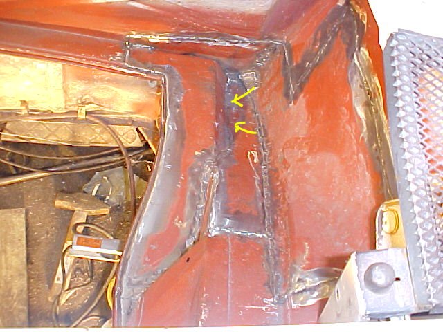

While going to the FFC this year we did drive in some rain. I have a GT lid on my car and while at the FFC myself and a few others noticed I had standing water in the hell hole. With Battery & ECU in the way it was hard to find the drain hole to unplug it so I just soaked up the water with a rag.
Fast forward to today while preping the car for winter I removed the battery and move the ECU out of the way to get a better look and there is NO drain hole? There is one on the driver side. There should be one right? I went under the car and I do not see one. Where I think one should be the fuel pump is there, so...... should there be one? My car is 70 model if that matters. I plan to drill a hole anyways but found it odd that there isn't one.

When I did mine last year I made a long slot so the water can drain under the engine tray.

itsa914   There should be a water drain hole   Nov 11 2005, 11:11 AM
jet1   there should be one right where the engine shelf m...   Nov 11 2005, 11:19 AM
Midtowner   Maybe it's crusted over. It's there. Or,...   Nov 11 2005, 11:21 AM
RON S.   It should have one.However if the shelf had at any...   Nov 11 2005, 11:24 AM
bd1308   what were you poking at then at the FFC? hey i ca...   Nov 11 2005, 11:25 AM
itsa914     Nov 11 2005, 11:34 AM
Bleyseng   the drain hole is on the left in this pic   Nov 11 2005, 11:50 AM
itsa914   Heading out to drill the drain hole, just need to ...   Nov 11 2005, 12:05 PM
SirAndy     Nov 11 2005, 12:10 PM
watsonrx13   Here's a shot of the drain hole from underneat...   Nov 11 2005, 12:13 PM
Eric_Shea   Make sure you drill it from underneath or right wh...   Nov 11 2005, 05:23 PM
McMark   And if your fuel pump is there watch out for it.   Nov 11 2005, 05:26 PM
