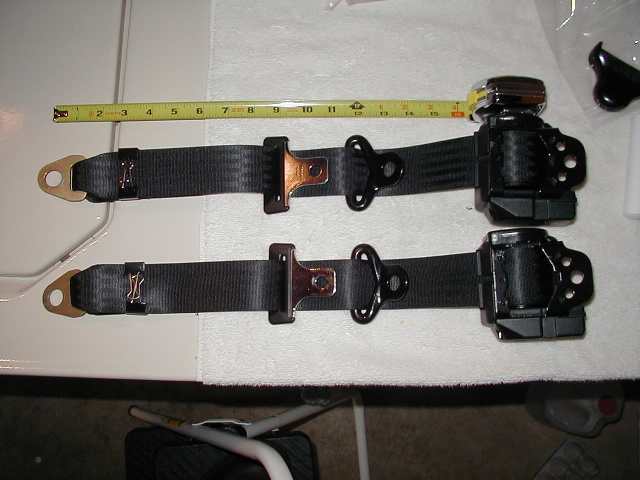

Midtowner   Okay, here we go: I ordered two 3-Point Retractabl...   Nov 17 2005, 09:34 PM

Midtowner   New Reels with old hardware...   Nov 17 2005, 09:37 PM
Midtowner   pic...   Nov 17 2005, 09:37 PM
Midtowner   Sorry, but I didn't take pictures of the new b...   Nov 17 2005, 09:39 PM
fiid   Would it be a problem to use the hardware they sup...   Nov 17 2005, 09:42 PM
Midtowner   One more pic. Check out the tag. May help with i...   Nov 17 2005, 09:42 PM
Midtowner   Yeah, I know what you are saying about taking apar...   Nov 17 2005, 09:47 PM
