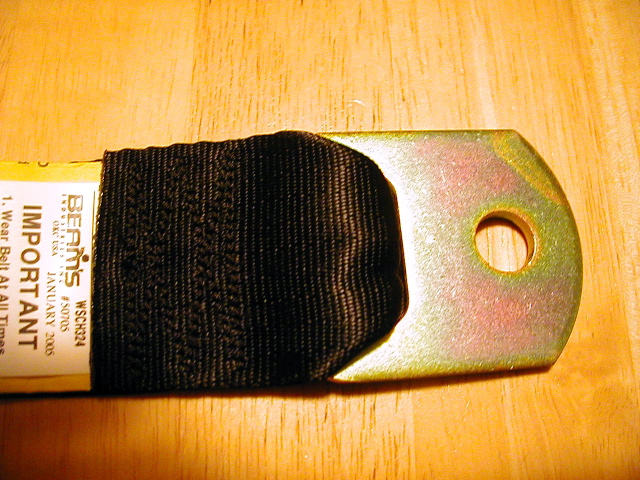

One more pic. Check out the tag. May help with identification. Have a great day! (IMG:http://www.914world.com/bbs2/html/emoticons/biggrin.gif)

fiid   Would it be a problem to use the hardware they sup...   Nov 17 2005, 09:42 PM
Midtowner   One more pic. Check out the tag. May help with i...   Nov 17 2005, 09:42 PM
Midtowner   Yeah, I know what you are saying about taking apar...   Nov 17 2005, 09:47 PM
