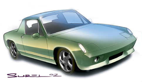

neo914 purpose: An exercise in creative design, to promote the enthusiasm for the 914 and introduce new ideas, designs, and components not previously installed on a 914…
"neo" translates to "New" in German thus "neo914-6"
What would a 914-6 look like today? Imagine the character of the 914 we all “grew” to love retained in a modern version…
Design sketched 8/05:
Car shown at SEMA 11/06:
Original 914 design:

Heres an early concept sketch for my car...
Maybe I will do some at lunch tomorrow
Mark

Andyrew   Wowsers!!! Simply amazing. I love the...   Sep 3 2005, 12:42 PM
Brent   Felix, It looks as if the front bumper is a cros...   Sep 3 2005, 01:10 PM

Travis Neff   Felix, the design in your drawing looks great, loo...   Sep 3 2005, 02:41 PM
