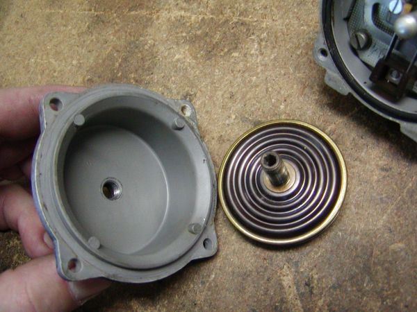

Be careful of what MPSs you might find...they are not all good to harvest parts from. One of our own sent me this one which does not have a diaphragm or even a place for a diaphragm!
(IMG:http://www.914world.com/bbs2/html/emoticons/biggrin.gif) Attached image(s)

The rear coil section seems to be similar enough to our MPSs, but thats where the similarities end. The aneroid cell has a fixed threaded allen key adjustment whcih only gives 0.004 Inductance adjustment, not sufficient for our needs. (IMG:http://www.914world.com/bbs2/html/emoticons/dry.gif)
