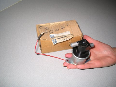

Do any of you guys know which early VW this NOS AAR is for? I bought it off of ebay a few years ago thinking it could be used for a D-Jet 914 but the hose connections are quite a bit smaller than the ones for a 914. Angled slightly different too.
Part Number 0 280 140 005 or VW Part Number 311 906 045 Attached image(s)

lapuwali The '68 Type 3 was, as far as I know, the firs... Dec 4 2005, 11:11 PM
Bleyseng early Type 3 mps doesnt use a diaphram but had a W... Dec 5 2005, 09:46 AM

lapuwali Late Type 3 ('70-'73). The '68-'6... Dec 5 2005, 03:02 PM
smg914 Thanks James. This type of detail will help me de... Dec 5 2005, 03:39 PM
