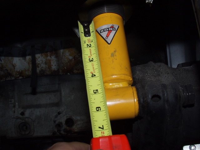

Billsteins with 5 notches.... 5" coleman collars......
???? most said 10" on This thread.... but a few use 8" will they work? can the 5" perch sit high enough on the Bilstein to have useful adjustment? i have a line on afco coil springs.....8" (IMG:http://www.914world.com/bbs2/html/emoticons/unsure.gif) |

Senior Member ![]() ![]() ![]() Group: Members Posts: 805 Joined: 20-August 03 From: San Jose, CA Member No.: 1,053 |
If it's at all useful(yeah I know they're not bilsteins). Here's some pics of it as low as it will go while just touching the bumpstops. The collars are about 6.5" from the bottom of the shock mounts.
