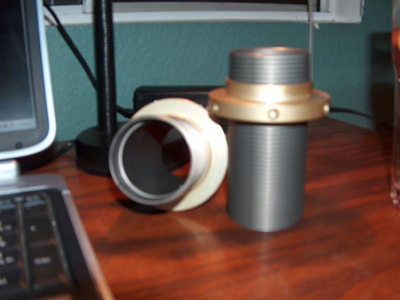

soo... i have these
user posted image
and my perches
user posted image
have the seating notch about .5" from the bottom....
so, if these were to sit on the top notch of the bilstein strut.... they would be ok with an 8" spring?

sj914
If it's at all useful(yeah I know they're not bilsteins). Here's some pics of it as low as it will go while just touching the bumpstops. The collars are about 6.5" from the bottom of the shock mounts.
