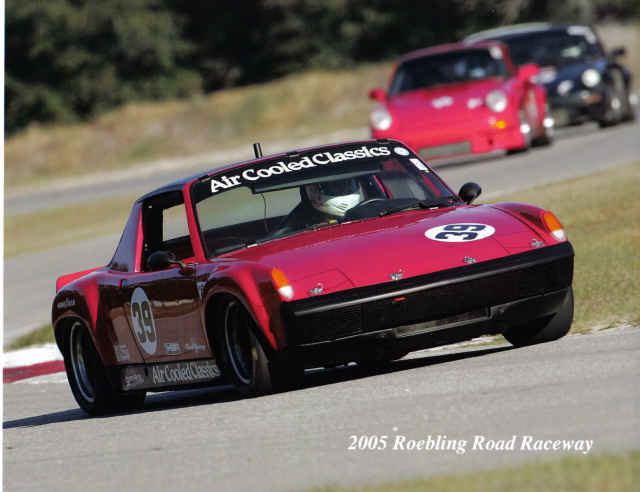

QUOTE (Brett W @ Dec 5 2005, 07:35 PM)
If you really want a bunch of fierce competition without getting your ass waxed by a large majority of the Toyotas, Mazdas, and Nissans, you should look at the HSR 2.0 Challenge series. The rules are pretty simple and they require a treaded tire, but you will be racing against some serious 914s and 911s. Those guys race really hard and it is clean. You will have some great racing and it will probably be less frustrating for a new entry into Club racing.
If you are serious about this I would look at buying Blakewell's old car. That car has a Preston built chassis and has been a front runner for many years in GT2. But be warned you will spend a large fortune to compete in the GT classes. A top GT2 competitor listed his championship car for sale at $350K.
Good luck. NOt trying to pee in your cheerios, just trying to lay out the facts.
We race a 70 914-6GT 2.0L in PCA and HSR.
We just won the PCA race at Roebling Road the last weekend in GT5R. (IMG:http://www.914world.com/bbs2/html/emoticons/smilie_pokal.gif)
