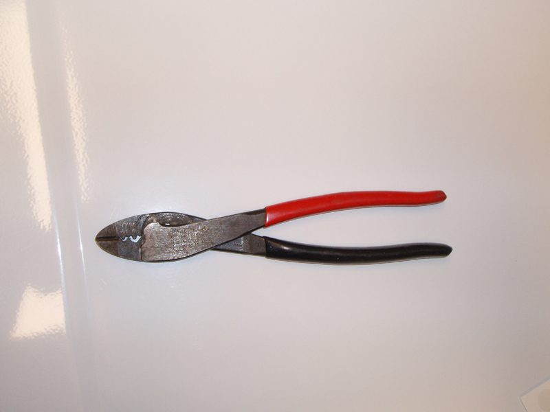

I spoke incorrectly. I have used the Thomas and Betts WT111M for years. The Klein looks a lot like it, but I didn't have access to my tools when I posted the first time. It's great. Wire range is 22-10AWG and it has 2 crimp sizes as well as a cutter.
(IMG:http://www.914world.com/bbs2/html/emoticons/agree.gif)
That's the best crimper! I have had the same pair for 18 years. I used to be the cellphone installer for Cellular One/AT&T when I was younger.

brownaar   The Klein 1005 crimper/cutter is the best general ...   Dec 13 2005, 09:05 AM

brownaar   Sorry, I spoke incorrectly. I have used the ...   Dec 13 2005, 01:59 PM
