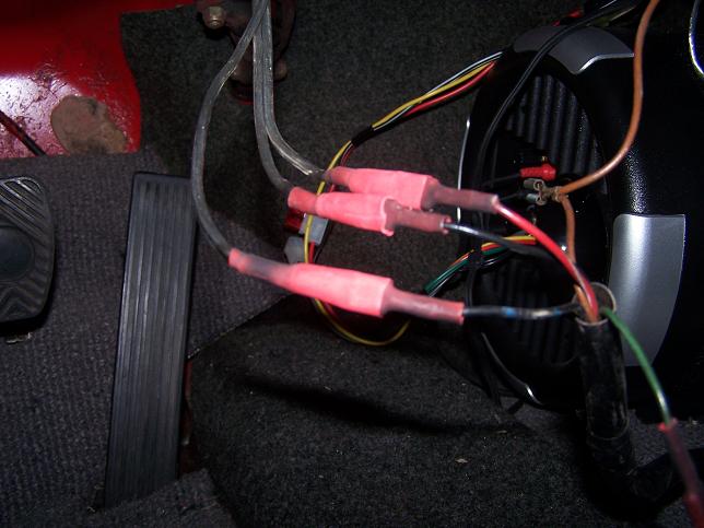

> crimpers, which work best
mightyohm
post Dec 12 2005, 11:15 PM
Posts: 2,279
Joined: 16-January 03
From: Seattle, WA
Member No.: 162
I want to invest in a nice set of crimpers for uninsulated crimp terminals. I want something better than the $9.99 radio shack style. Ratcheting would be nice if it makes a better crimp. Does anyone here have any suggestions? I don't want to spend over $100.
This is the kind I don't want:
(IMG:http://www.sunshinesolar.co.uk/ccp51/media/images/product_detail/crimper200.jpg)
Sorry I couldn't find a better pic.
