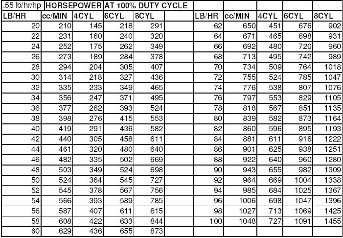

For those who have installed aftermarket EFI systems, what size injectors would you recommend for what is basically a stock 2.0L four-banger?
-slightly- higher compression than stock, with headers and I/R throttles.
The basic calculations I did say that 17# is enough, so I figure some nice Ford 19# injectors would be just fine. Am I off base here?

Here's a chart
