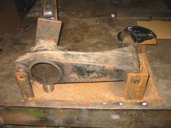

Specifically I am looking for rotational stiffness (ie. twist) of the trailing arm due to the tire contact patch resisting sideways sliding of the car. I'm only interested in forces greater than 1G during cornering.
I already know what happens but go ahead and take a guess. (IMG:style_emoticons/default/biggrin.gif)
I'll post pictures of my test fixture shortly.

So far JP is the only one really on the right track. (IMG:style_emoticons/default/smile.gif)
You're only off by a factor of two.
What I did was mount the trailing arm pivot shaft in a support fixture I fabricated. Then I welded the base plate of the fixture to my 800lb welding bench.

Racer Chris   So far JP is the only one really on the right trac...   Dec 16 2005, 08:24 PM
Racer Chris   Then I attached a 5ft piece of structural tubing t...   Dec 16 2005, 08:26 PM
Racer Chris   by putting a 200lb man's weight at the end of ...   Dec 16 2005, 08:32 PM
Racer Chris   I had a friend sit on the end of the tube and saw ...   Dec 16 2005, 08:34 PM
Racer Chris   I have several more tests planned already. 1) meas...   Dec 16 2005, 08:40 PM
