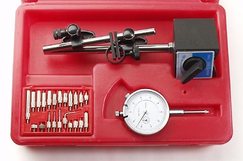

If I had a strain gauge laying around the shop it would have been on the trailing arm.
come on Chris, you've got to have one of these sets to use to measure deflection (IMG:http://www.914world.com/bbs2/html/emoticons/smile.gif)

Racer Chris   Mike, I have a dial indicator and mag base but not...   Dec 17 2005, 06:36 AM
