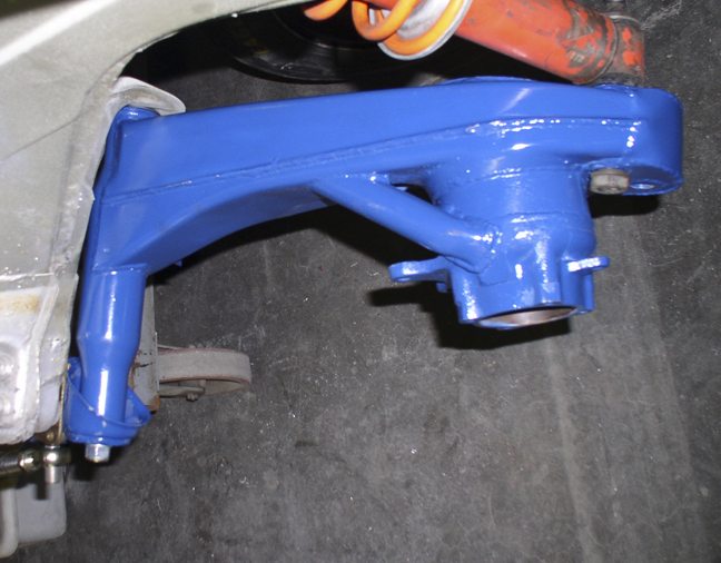

Here is the way we reinforce trailing arms. It isn't an original idea and most of you have probably seen it before, but here's a pic just in case. Its a 'tubular" method...
The tube goes from the bearing carrier diagonally through both sides of the arm. Triagulates and stiffens the walls of the arm in one shot.
Never have tested one, maybe we should send one out to you so it can be compared to others on the same rig. It would be nice to know if we are accomplishing anything.... (IMG:http://www.914world.com/bbs2/html/emoticons/laugh.gif)

Mugs914   Here's a shot that shows where the tube comes ...   Dec 17 2005, 09:32 PM
Mugs914   Outboard side...   Dec 17 2005, 09:33 PM
