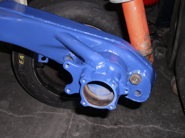

Mugs914
post Dec 17 2005, 09:33 PM
"Hey, yellow IS faster!"
Posts: 618
Joined: 22-July 05
From: Temple TEXAS
Member No.: 4,452
Outboard side...

Mugs914   Here's a shot that shows where the tube comes ...   Dec 17 2005, 09:32 PM
Mugs914   Outboard side...   Dec 17 2005, 09:33 PM
McMark   That arm has an option for increased shock travel?...   Dec 17 2005, 10:04 PM
