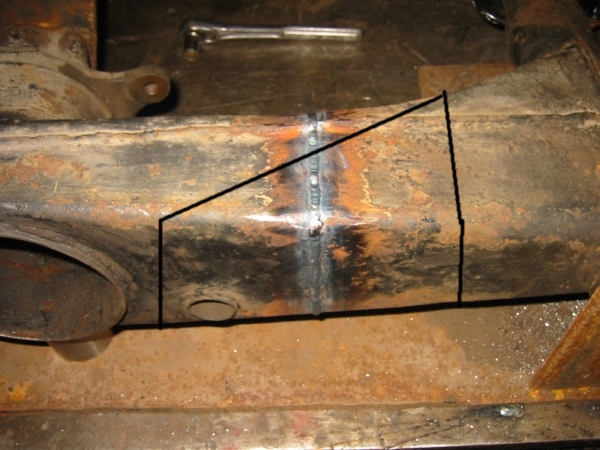

Here's a diagram of what I intend to try next. Move the slice forward (to the right) about 3", and add a diagonal plate inside as well.
BTW, some further testing revealed that the pivot tube does flex outboard of where the box section attaches. I will investigate this in more detail as well.
