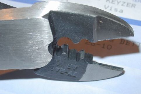

Well I took the advice of several folks here and bought a Thomas and Betts WT111M STA-KON Terminal Installing Tool, this is the same one shown in the picture above with the red and black handles.
This is a NICE tool. Specialized Products had one of the lowest prices around, $34 plus S/H.
http://www.specialized.net/ecommerce/shop/...duct_id=272X190
Here is a closeup of the crimping end of the tool. Notice how WIDE the dies are. The tool has some weight to it and the long handles give much needed leverage for crimping larger diameter wires. You can make gorgeous crimps without straining your hands.
