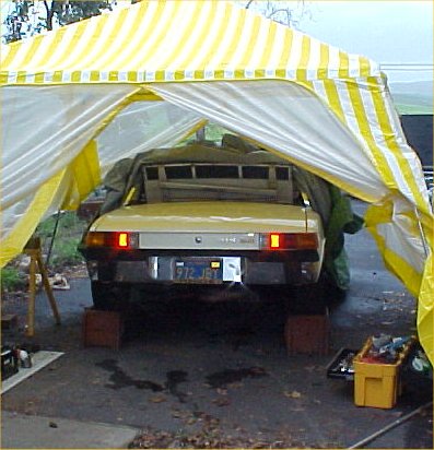

I've done at least five engine swaps in various vehicles, including my SIX conversion.
The longest swap was the SIX. After I had all the parts I spent parts of three weeks from running FOUR to running SIX including the engine compartment rust repair and paint.
I'm no superman...It just doesn't take that long.
I did my work under a tarp, outside, in the rain, at night (IMG:http://www.914world.com/bbs2/html/emoticons/ohmy.gif)
Put me in a shop with light, dry and warm and I'll go faster.
I would honestly, overestimate, a Soob conversion done, by me, solo, would be two weeks...
Or 80 hours...Max.
I'd do a V-8, though... (IMG:http://www.914world.com/bbs2/html/emoticons/cool.gif)
