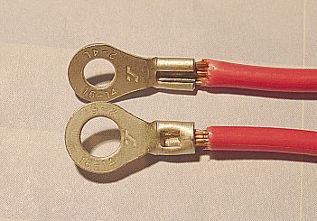

Here is a comparison of a crimp with the WT111M (top) and a cheapo $10 crimp tool using the non-insul part of the tool (closer to the handle).
The top crimp has a lot more area and took a lot less effort than the bottom crimp. The top crimp also has a much nicer shape and doesn't show bulging of the barrel towards the open end, which I am guessing means a more secure connection.
