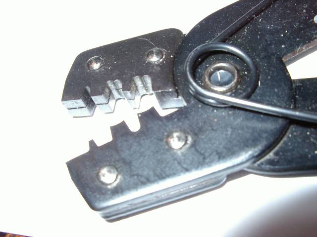

Here's the crimp tool I use.

lapuwali   Here's the crimp tool I use.   Dec 23 2005, 03:12 PM

lapuwali   The tool I got at Radio Shack for something like ...   Dec 23 2005, 03:33 PM
