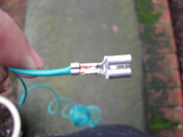

Here's an example of a crimped connection. Note this takes two crimps, one for the wire, one for the insulation strain relief. I also randomly grabbed a 14g connector and stuck it on an 18g wire, so the wire crimp part isn't perfect. The 18g connector is smaller, and the wire would fill it better.
