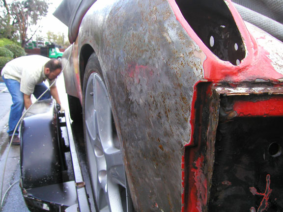

neo914-6   Mike the Man Mueller delivered neo914-6 from Mark...   Dec 28 2005, 11:55 PM
neo914-6   Mark did a fantastic job with the custom metal wor...   Dec 29 2005, 12:00 AM
neo914-6   After Mike unloaded my car we loaded Jon's Wat...   Dec 29 2005, 12:13 AM
