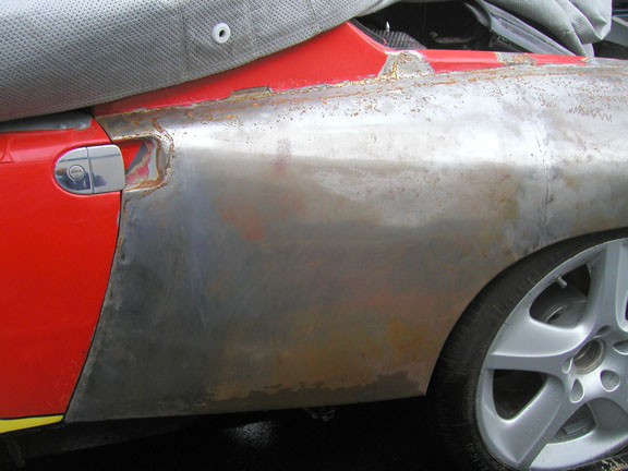

Mark did a fantastic job with the custom metal work. He welded (IMG:http://www.914world.com/bbs2/html/emoticons/welder.gif) on new front fenders and formed (IMG:http://www.914world.com/bbs2/html/emoticons/smash.gif) them ala John Kelly on-car technique. He (IMG:http://www.914world.com/bbs2/html/emoticons/sawzall-smiley.gif) and butt welded John's "big A$$" rear flares, yes pun. (IMG:http://www.914world.com/bbs2/html/emoticons/laugh.gif) He filled in all the DZUS , side marker and antenna holes. He extended the seal channel for the headlight delete hood. He also installed the Engman stiff kit and made the GT3 Recaro seat mount work. (IMG:http://www.914world.com/bbs2/html/emoticons/clap.gif)

neo914-6   Mark did a fantastic job with the custom metal wor...   Dec 29 2005, 12:00 AM
