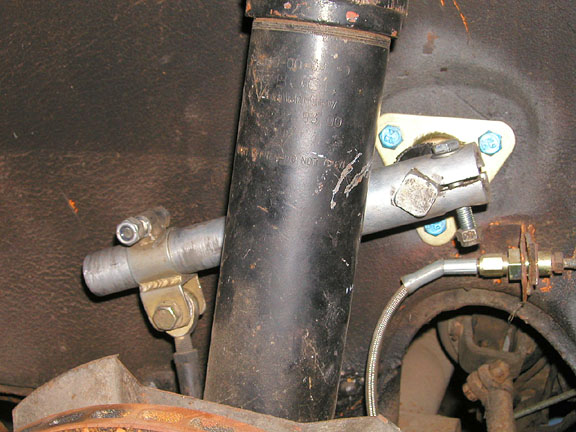

Monthly update: (IMG:http://www.914world.com/bbs2/html/emoticons/laugh.gif)
Got the bar in but don't know where to set the down link on the horizontal bar. (IMG:http://www.914world.com/bbs2/html/emoticons/confused24.gif)

neo914-6   Monthly update: http://www.914w...   Dec 29 2005, 02:06 AM
neo914-6   Also, do I leave the space in the u-tab on both si...   Dec 29 2005, 02:09 AM

sj914   You could try a shop that does suspension work. h...   Dec 29 2005, 05:31 PM
BIGKAT_83   http://www.914world.com/bbs2/h...   Dec 29 2005, 06:29 PM
