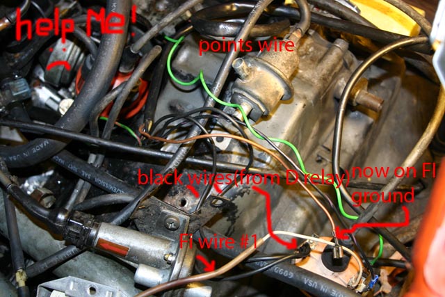

okay, so I know that L-jet uses the point pulses to fire injectors...my main relay is working, so what connections do i need at the coil?
i already have the tach wire, the point wire at the neg and nothing at the positive....
but i have a brown wire and two black wires joined to one both sets of wires having 12VDC on them....what gives?

here's a pic. I dont even have spark now, and I had it yesterday.
The spade connector is laying in the relay board now, so i doubt it wouls stretch to the other side of the engine. Everything is there, and it *SHOULD* work, but i get neither spark nor fuel and i have voltage in all the right places.

bd1308   here's a pic. I dont even have spark now, and ...   Dec 29 2005, 11:10 AM
r_towle   start simple. Do you have power to the coil, key o...   Dec 29 2005, 11:20 AM
bd1308   i do have power to the coil, 12V at one end and th...   Dec 29 2005, 11:22 AM
