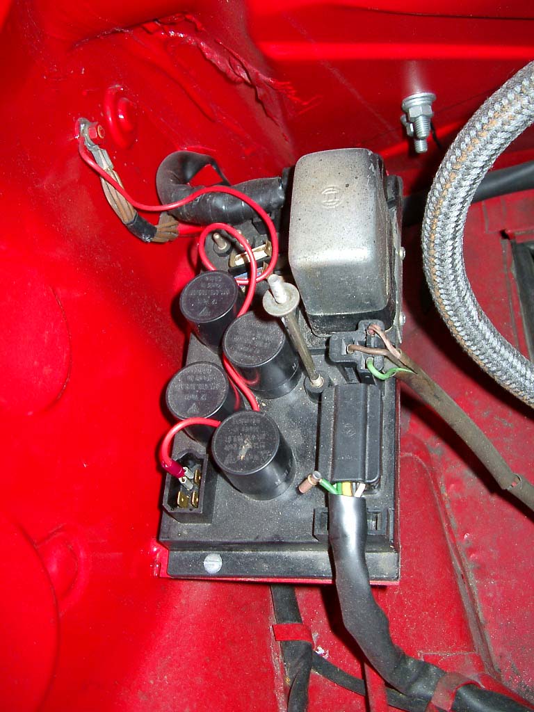

okay, so I know that L-jet uses the point pulses to fire injectors...my main relay is working, so what connections do i need at the coil?
i already have the tach wire, the point wire at the neg and nothing at the positive....
but i have a brown wire and two black wires joined to one both sets of wires having 12VDC on them....what gives?

You could jumper a ground to make the fuel pump run per this pic.
This would energize the fuel pump relay when the key is on (as long as you are still using the fuel pump relay on the relay board).

JOHNMAN   You could jumper a ground to make the fuel pump ru...   Dec 29 2005, 12:41 PM
