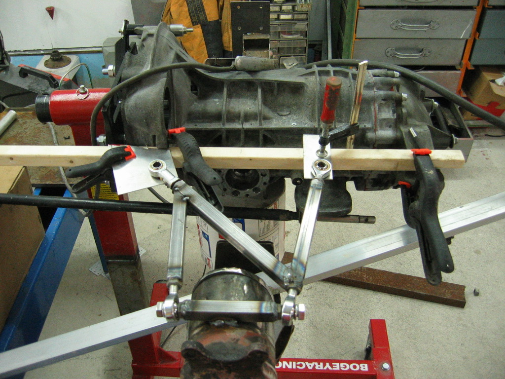

I had couple of hours to work on suspension today.
upper link 80% ready, actually these first ones i'am only using as a tool to make jig.
this upper will have adjuster in the front link. that is used for adjusting toe.
(IMG:http://www.914world.com/bbs2/uploads_offsite/fvwa.sitefactory.fi-179-1274375996.1.JPG)
(IMG:http://www.914world.com/bbs2/uploads_offsite/fvwa.sitefactory.fi-179-1274376001.2.JPG)

slugmika   Happy New Year to all of you http:/...   Jan 1 2006, 02:04 AM
slugmika   Upper pick up point in its place. I made the actua...   Jan 1 2006, 09:55 AM
Jeroen   did you just weld nuts to the ends of the square t...   Jan 1 2006, 12:14 PM
slugmika   Hi Jeroen Yes i just welded nuts. But these are n...   Jan 1 2006, 12:53 PM

slugmika   Left side is finally finished. Hub is ready and wh...   Jan 30 2006, 01:22 AM
racerx7   It looks very impressive. How do you go about fig...   Jan 30 2006, 01:32 AM
slugmika   I'we been drawing and simulating these in pape...   Jan 30 2006, 03:06 AM
racerx7   First let me say you know a lot more than I do. I ...   Jan 30 2006, 04:19 AM
slugmika   At the moment toe is not changing thru the travel ...   Jan 30 2006, 05:09 AM
