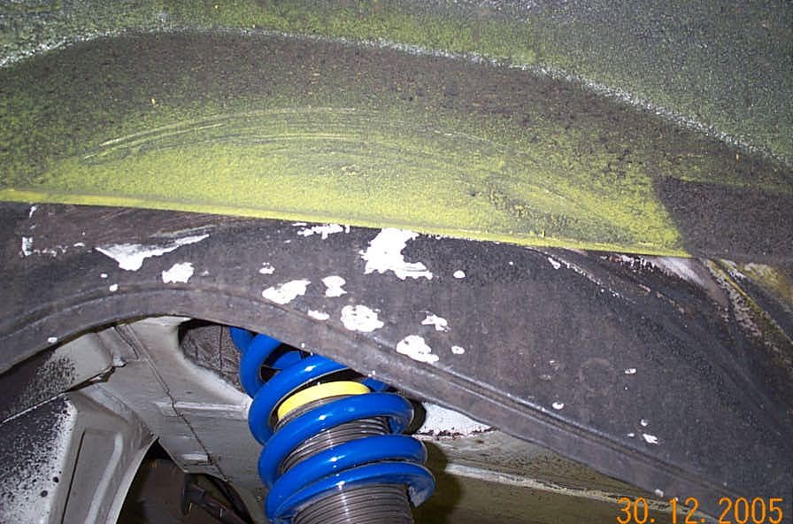

How much fender clearance is a safe distance for the inner fender wells and the tire.
Right now I'm measuring about 1" between tire and fender well on 25" tires. I'll have pics of it tomorrow.
I'm talking about the rear.

The worst point of contact is the lower RH coner of the pic...out of the frame cause I blew it.
This is with a tight (3/8 in) finger of clearance at static height.
Camber change, side wall flex....whatever, uses up space pretty qiuck..... there it is at the top of the tiar also.

Andyrew   I'd say 1inch is enough. I have 1/2 and it wor...   Dec 30 2005, 04:18 AM
sj914   Alright it's tomorrow already. here's wha...   Dec 30 2005, 04:19 AM
sj914   Here it is with the suspension bottomed out (well ...   Dec 30 2005, 04:21 AM
sj914   Here's a shot from behind. Still seeing some ...   Dec 30 2005, 04:23 AM
airsix   That looks okay to me. What is that, about 3/4" ga...   Dec 30 2005, 12:07 PM
bondo   Won't you hit the control arm before the inner...   Dec 30 2005, 12:19 PM
sj914   3/4" is what was left.   Dec 30 2005, 12:36 PM
sj914     Dec 30 2005, 12:38 PM
neo914-6   probably meant the "trailing" arm... In Andrew...   Dec 30 2005, 12:47 PM
sj914   ...   Dec 30 2005, 01:06 PM
J P Stein   To check full suspension travel in the rear, ya go...   Dec 30 2005, 01:12 PM
sj914   I haven't even got to checking the fronts yet ...   Dec 30 2005, 01:19 PM
neo914-6     Dec 30 2005, 01:28 PM
Andyrew   I had an 1/8th of an inch of clearance and it rubb...   Dec 30 2005, 02:30 PM
bondo   ...   Dec 30 2005, 03:33 PM
bondo   <...   Dec 30 2005, 03:36 PM
sj914   The part I was worried about most was the section ...   Dec 30 2005, 04:28 PM
smooth_eddy   I can barely slip my index finger b/t the tire and...   Dec 30 2005, 05:32 PM
